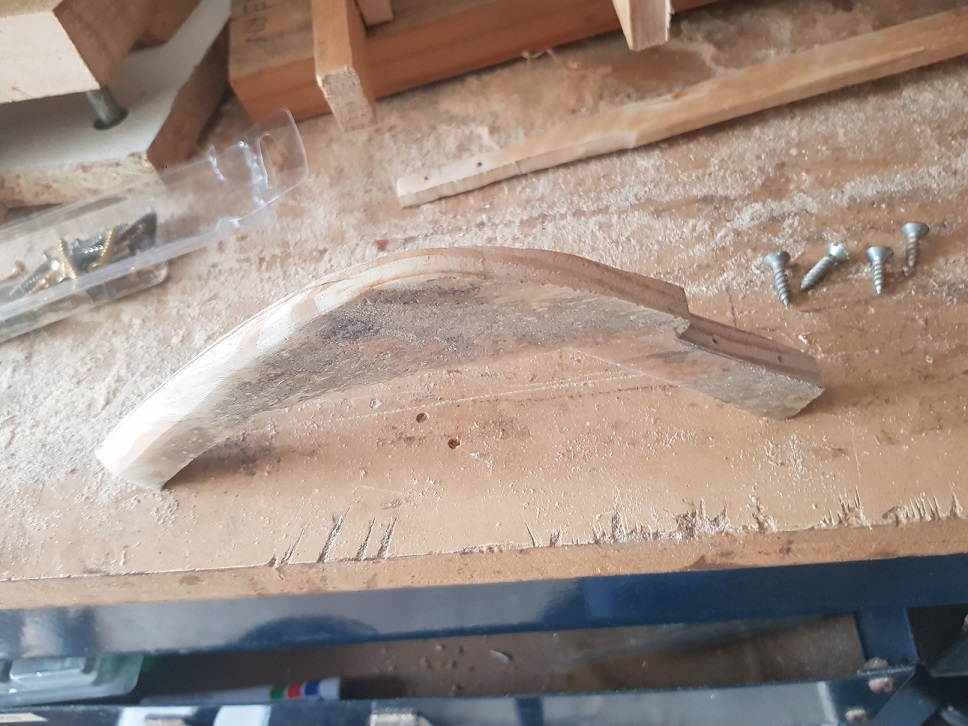

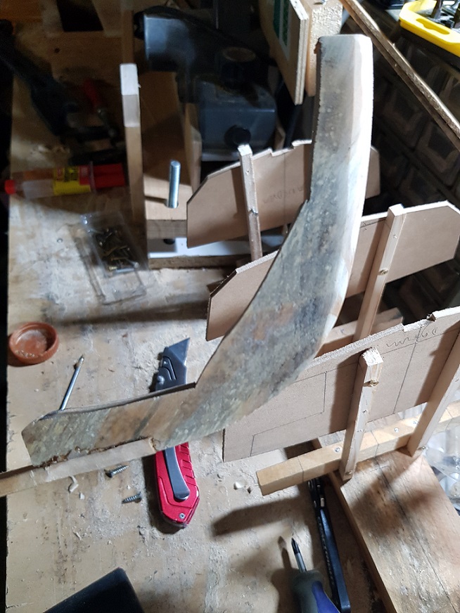

I have had the plans for a couple of years now, and just added the Selway-Fisher plans to them. As there does not appear to be any written instructions on the build process, and I am a total novice, I am looking for somewhere where I can ask all the dumb newbie questions.
My play is to build a Senior with a 10% upscale - to give my old legs and head a little more space - and I am starting with a 1:8th scale model, but in starting that I came across my first dumb question.

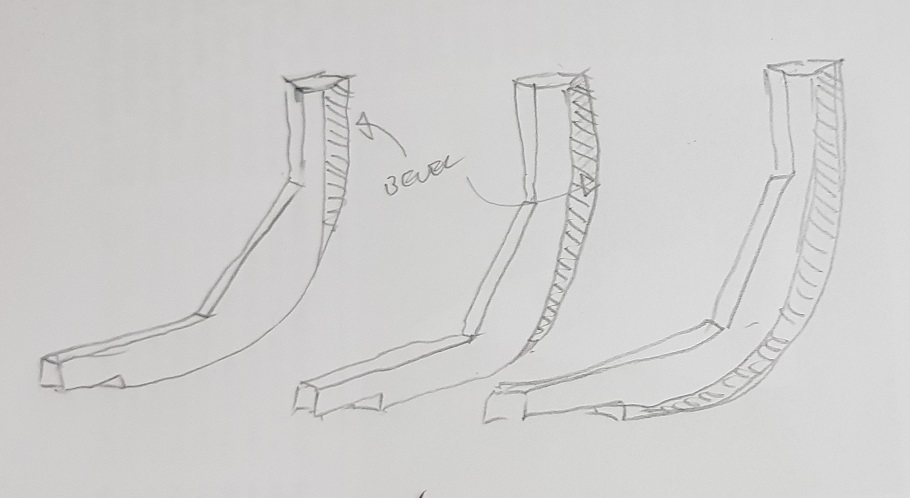

To build the stem, it shows to cut a bevel in the front of the stem, but does not indicate how far to carry this bevel. Is it just on the front face? Should it continue around the curve at the foot of the stem, or even futher and right round until it joins the hog?

The stem can initially be bevelled purely to make removing more wood easier when the framework is being prepared for the ply skin.
With my first plywood build only a small amount of bevelling was done down as far as the lower chine, after setting up and fixing frames, chines, hog, inwales etc, I used a strip of ply laid across the framework and slowly planed the framing and stem until the ply laid perfectly flat,
At the stem the bevel got flatter as I worked down towards the hog.
Hope this makes sense
Cheers Mat

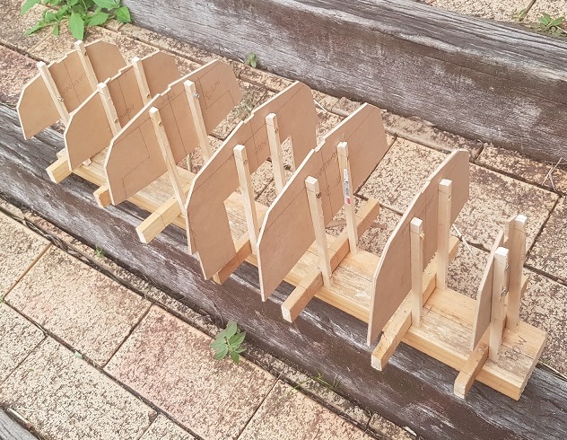

Getting the frames set up now. Just using some old MDF (yuk) as the frames.
