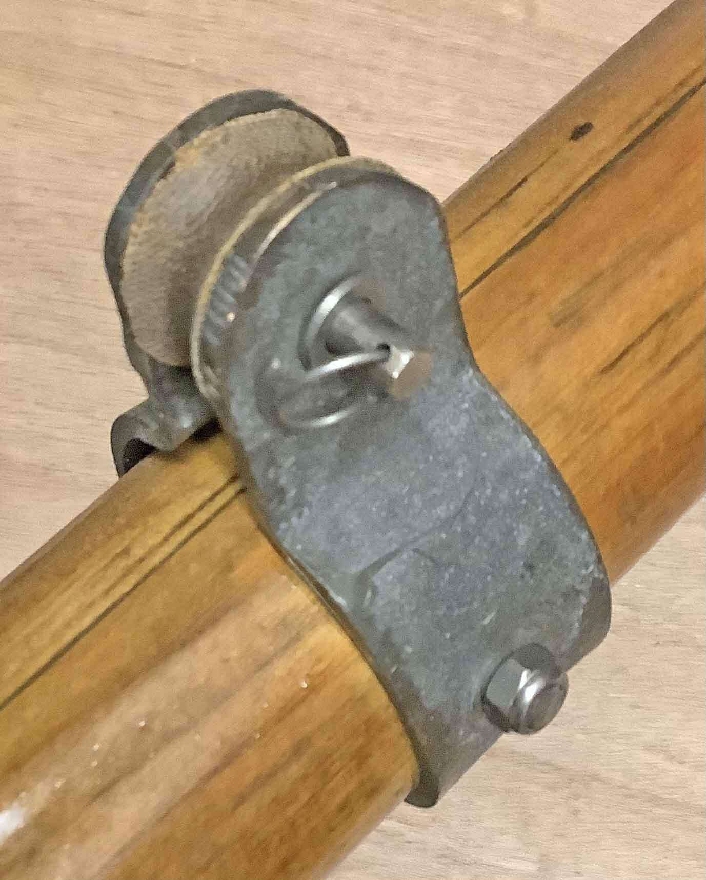

Two rows of reef points, first row 24 inches above boom, second set 24 inches above first set.
Halyard pulley on gaff 57.5 inches from throat.
Photos to follow.
Your Senior is looking good, please keep us updated on progress.
Cheers Mat
Photos to follow.
Cheers Mat

Halyard slider, gaff pulley

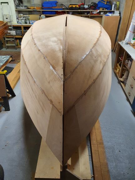

I am making steady progress with my build and have now epoxied the hull panels. Once filled and faired I will sheath the hull rather than taping the seams.
All the best
Keith
All copied to my files for use when I make my spars.
All the best
Keith

Re: Calling all Senior owners, builders and dreamers!
Looking good Keith, if there is anything else you need please let me know.
Cheers Mat

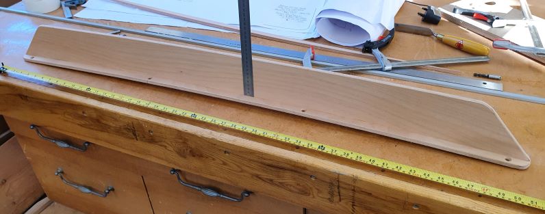

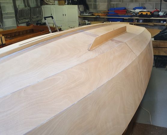

Hi Mat
Although I am building a centre board version of the Senior I am planning to get a couple of small steel bilge keels made up so that she can comfortably take the ground when needed. The boats keel would still take the weight of the boat and the bilge keels would support her laterally at such times. Each one should weigh circa 15kg and so they will provide a little more stability to the boat as well. The only down side I have thought of is that they will move the centre of effort aft fractionally, but from what I read that shouldn't pose too much of an issue.
Can you or any other Senior owners think of any problems with such an approach (I have reinforced inside the hull and each would be bolted through one of the floors also). The pics show the plywood mock up that will go to the steel fabricator.
All the best
Keith
All the best
Keith

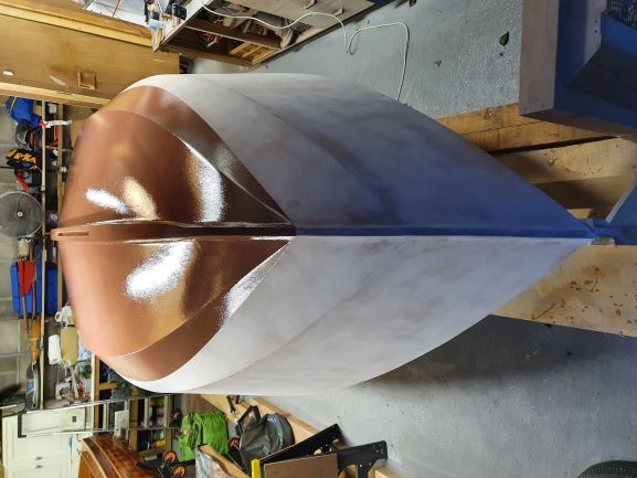

7 coats of Coppercoat applied. Brilliant antifoul, but in this context, super tough epoxy / copper finish for the rigours of a beachable trailer sailer.

Hi Keith
I think the shallow bilge runners are a good idea, I’d thought about doing something similar on Bethem. Another idea was the addition of a skeg, although this would move the ce further aft as well.
What I noticed when using the outboard was the boat did not track well if the centreplate is raised so the additional keels would keep her going in a straight line.
The other advantage is you are protecting the hull when drying out and the extra ballast will help.
Bethem sits on a simple trailer with keel and side rollers and is easy to get on and off for launching so I don’t know if the additional keels would complicate this.
I’m presently playing with a 45lbs thrust electric outboard linked to two 12v gel batteries which are fitted either side of the centreplate casing, each weigh 50lbs, so with the centreplate gives 180lbs of ballast. A solar panel is fitted to the foredeck, which despite the size does not cause any issues when walking on the deck.
Btw your hull looks superb!
Cheers Mat

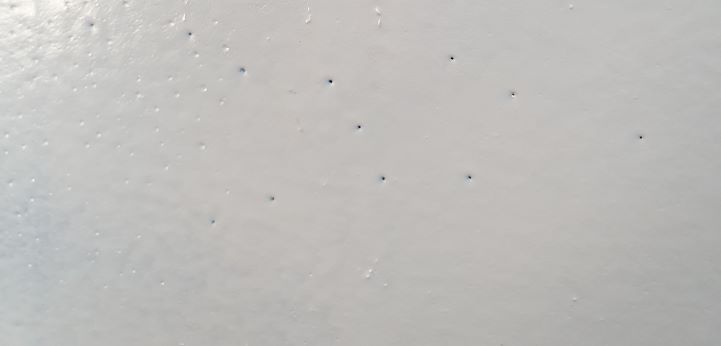

Thanks re your comment concerning the hull. I was really pleased until I applied the Hempel Light Primer today. It appears that I have pin prick holes all over it! Most frustrating.
Coincidentally I have confirmed the order for small bilge keels from a local metal worker today. They will be done by the end of January. It wont stop progress.
I agree re the trailer but I am hoping that if I am canny about its design they might actually help me to ensure she sits central to the centreline rollers on recovery. We shall see. If anyone has an old trailer looking for a new home please let me know!

I am hoping further coats of Light Primer might do the trick but fear that I might have to fill them all. They are all over. Grrrrr. I used west 407 filler for filling the weave. Quite 'wet'. I had not used it before. Think I will revert to glass bubbles should I ever do another similar build.
