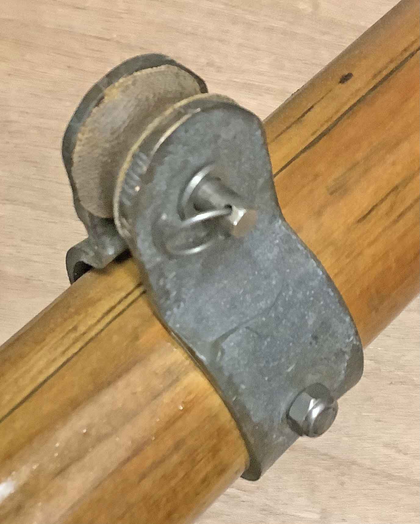

The complete Gunter rig came off a Senior which was being broken up, and all the spars are as per the plans. The only slight discrepancy I could see is the position of the pulley on the gaff, mine is positioned 58 inches from the throat end.
Starting with the mast, a sail track is fitted about a foot above the base and stops just shy of the halyard pulley at the top.
On the gaff throat is fitted a dinghy style gooseneck which suits the mast track. Further along is a strap round the gaff with a pulley.
A stainless sail slide goes in the mast track first and the halyard is made fast to this, then the gaff is slid on, halyard goes though gaff pulley then up to mast sheave.
The sail, although fitted with ten eyelets along the luff I only fitted sail slides in five of these to cut down friction.
In practice as you haul on halyard the gaff throat stays down as the rest of the gaff rises and lays parallel to the mast, then it all goes up.

Two rows of reef points, first row 24 inches above boom, second set 24 inches above first set.
Halyard pulley on gaff 57.5 inches from throat.
Photos to follow.

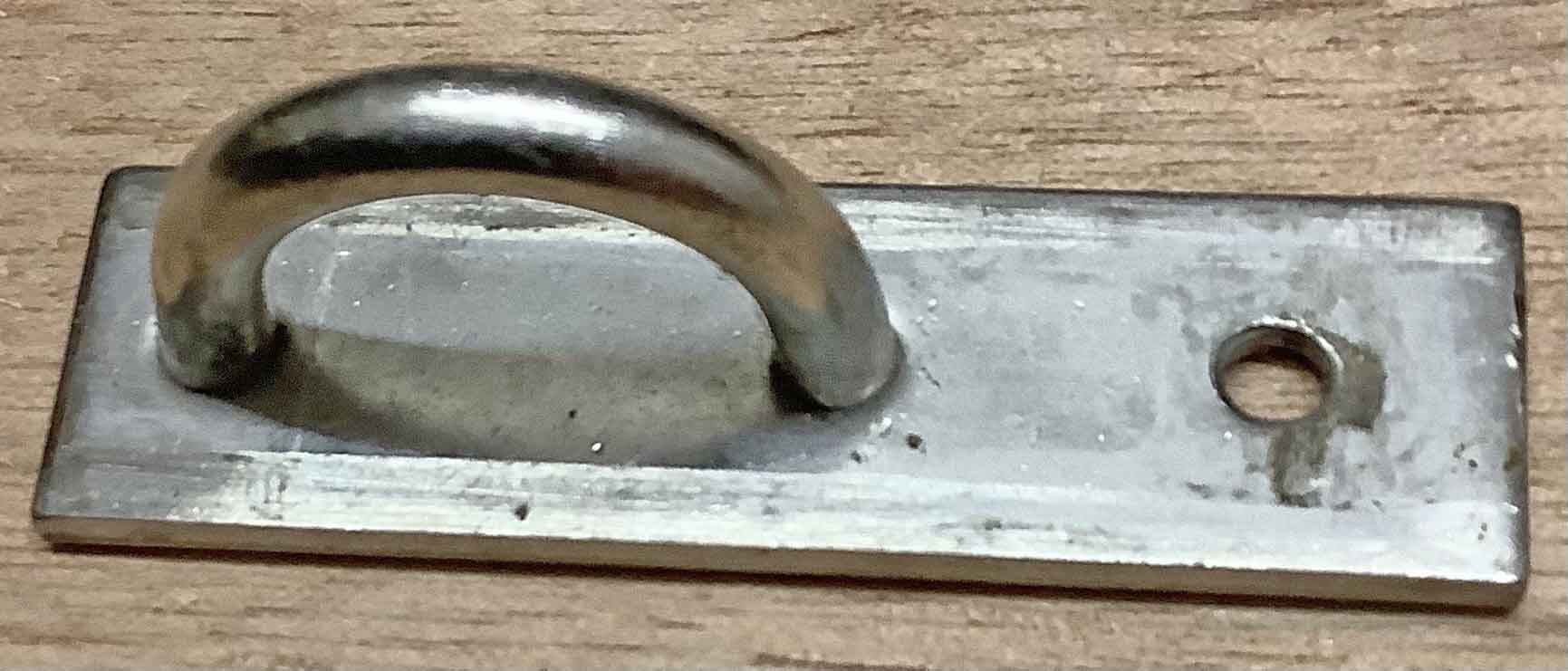

Re: Calling all Senior owners, builders and dreamers!
Posted: Fri October 30th, 2020, 7:37 pm
by Bethem
Halyard slider, gaff pulley
- Halyard slide
- 41C5612E-AED9-4CA9-BAD1-7FA17DA221FE.jpeg (175.3 KiB) Viewed 545595 times
- Gaff pulley
- 366386B7-162C-41FB-83AD-AC90C3DDCB08.jpeg (237.86 KiB) Viewed 545595 times
